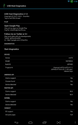

I have rot checker and it say I am rooted... I have tried even the other software of chainfire which is USB diagnostic and it is not a problem with stickmount but with the tablet's ability to have a driver for mass storage devices in general which is not compiled into their kernel.... please see results below. Thank you! $Screenshot_2013-09-07-03-58-56.png

I am sharing a response from hisense regarding USB mass storage and this won't be available at all with the sero 7 pro but lite is a different story..... so in short need to purchase Nexus Media Importer instead to have this working for your tablet...
R***** S******** <R*****.*@hisense-usa.com>
11:53 PM (42 minutes ago)
to me
Hello Mr.Calero,
I am responding to your issues to the tablet. As far as connecting a flash disk with an OTG cable it is not going to be compatible with Sero 7 pro. That feature is available to for use on the Sero 7 lite but not Pro. We have every intention on releasing the kernel source for the tablet but at this moment it is not available.
