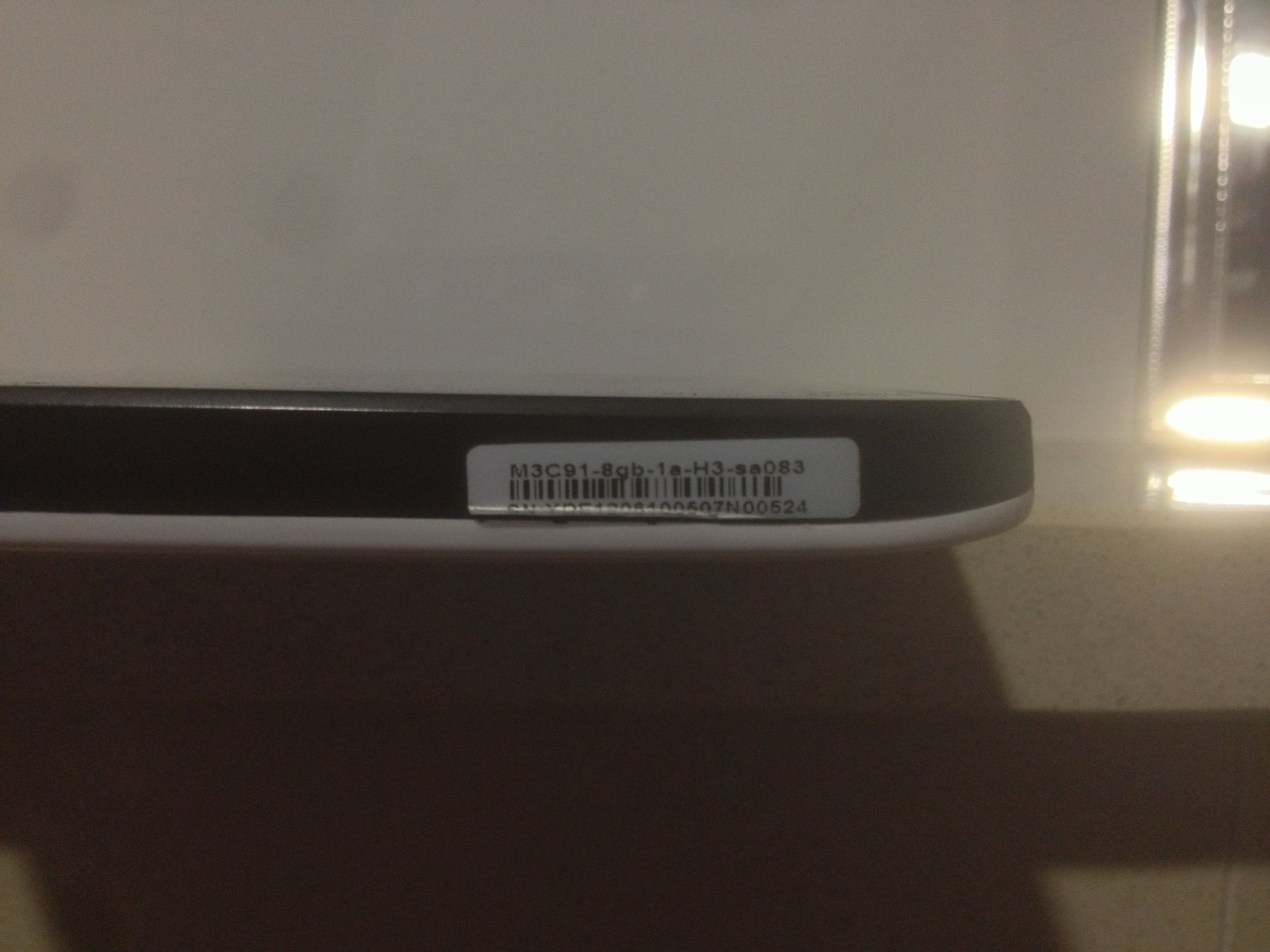

    The barcode sticker should be on the tablet itself, not the box.... Something like ZT280H13NC91M512F8 or M3C91-8gb-1a-H3-sa083 [​IMG]
    Hmmm, without testing, not sure how to figure out which tablet you have....
    When you flashed the 0314 ROM, which files did you add to the zt-update folder before putting it on your sdcard to flash the tablet?
    If your tablet has 512MB (or less) RAM it's a ZT-280, if it has 1GB RAM it's a ZT-282....
    If it has an Amlogic M1 CPU it's a ZT-280, Amlogic M3 CPU is a ZT-282....
    I think the differences in the ZT-280 models are the touchscreen or the camera, and with the ZT-282s it is just the touchscreen.....
    Since you flashed a ZT-280 ROM and your wifi isn't working, probably best to try a ZT-282 ROM....
