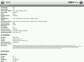

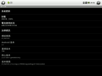

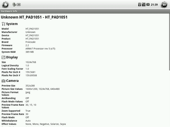

this is what i found on my device.
Model no; HT_PAD1051
Android ver: 2.2
Kernel version : 2.6.31-00011-ge4e866b-dirty
Build number : HT_PAD1051_V1.6.1-eng2.2 FRF858 eng.tianfeng.20110425.222822
Single speaker and charging port on right hand .
volume control and screen lock on your right hand
audio out 2.5mm and reset port (paper clip size) on your left and power up button on your right. Capacitive touch screen and home button in the lower center of the tablet 30pins connector. no GPS, support external 3G and bluetooth. 32gb TF card slot.
i have this problem now is that the invert screen for some apps. is this due to the G snesor? any way to correct it?
