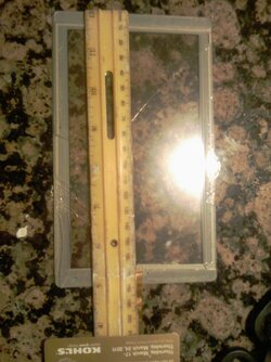

I dropped my Sylvania tablet on an unpadded section of plush carpet, and the screen shattered. Seems like there should have been a small buffer between the bezel and the glass itself, but I'm no engineer. Anyway, does anyone have an idea where to purchase a new touch screen panel? I see the following # inside the glass YY-D0272 1010. It's a 4 wire cable which is located exactly half way down the middle of the short edge of the screen.
So here's the response from DigitalGadgets:
Unfortunately we do not repair units, nor do we offer replacement parts.
If anyone is watching, this is the screen and the 4 wire cable placement. Couldn't find anything identical on ebay so far.
http://www.weidners.us/sylvania_digitizer.jpg

Here's my question: This tablet is from china, and I dropped it a few days back causing the screen to crack which disabled the touch screen. I disassembled it, removing the touch screen and see the following part number on the screen: AP580CA-A2. I have looked around everywhere but cannot seem to find the exact screen with part number. How specific are the screens in terms of replacement? Would I be able to use another 7" screen that also has 4 wires? Where could I find this screen part, or similar, online?

The trick here that everybody is missing is we all have a 7" tablet with a broken screen. The screen is not 7" it is more like 6.5 inches.
There are several listings for 6.5 digitizers and the ribbons cables are at the short end of the digitizer which is where most of them are.
The generic tablets come out the side mostly and I have purchased a few already.
