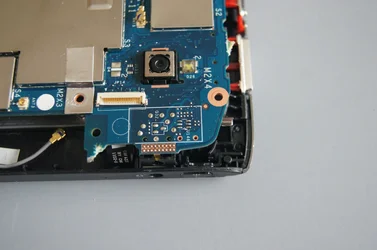

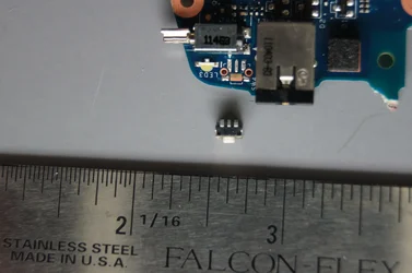

Here are a few photos that I took while I was repairing my switch.
Photo 1 is the back side of the circuit board where the switch is.
Photo 2 is the switch side of the circuit board with the switch next to it. I turned the switch upside down so the solder connections are visible. The ruler gives you an idea just how tiny the switch is. My A500 had not been dropped but switch came completely loose. The switch was only held in place by a couple of microscopic solder connections.

Photo 4 is my solution of not having a solder tip small enough to get to the solder joints. The distance between the vibrator and the switch is perhaps 1/8 of an inch. I wrapped some fine wire around the tip of my soldering iron so I could reach into the gap. A strong light and a magnifying glass was necessary so I could see what I was doing.
If you are going to attempt this repair, first remove the extra memory card if you are using on. Go to YouTube to see how the case is opened (which is the easy part of the process). Open the case, then remove the battery. The screws that hold the mother board in place are marked with large copper rings around them except on one more that appears to be holding down a strip of aluminum foil. Carefully put the screws into a cup so that you don't loose them. Take only the electrical connectors off that you absolutely need to.
After you get done soldering, carefully remove any loose blobs of solder that you may have created. The tolerances are so close that even a small piece of solder can short things our.
Keep your fingers crossed, this is a very challenging repair.
