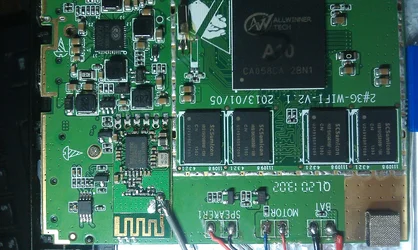

While upgrading my CnM Touchpad 9.7SC tab from official website 9.7SC | Single Core | Downloads | Support | Official Website of CnM Lifestyle screen gone white please help me to find right firmware. I have used stock ROM from official web page I think CnM made a mistake with some of their tablet firmwares, causing a white screen issue; therefore I am in search of similar firmware that can be installed on my device. On official web page there are only two firmwares available for my device i.e cnM touchpad 9.7 SC not other than that and I have tried both. I have tried multi Allwinner a10 custom firmwares from different webpages but PhoenixSuite showing error fel2fes & sometimes PheonixSuite starts the procedure 3mins left then after a second or two displays The error is, Upgrade fails : 0x120 Ó²¼þʧ°Ü1. Livesuite also showing an error update failed : 0x120. Here is my chip ID Allwinner A10 CA058CA 2BN1 (QL20 13.02) please help to find correct firmware. Guys your co-operation in this regard will be highly appreciated, please. $IMAG0003 (2).webp
Sir I have tried both but result is same (White screen). Is there any similar firmware thats match with obove mention board. Thanks again for reply
Thanks to reply. If you find any of clone or similar firmware please send me link I will be very greatful for this kind of act thanks again and best regards.
