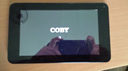

Hello Guys
I also have a MID7060 and i am trying to root it to MID7065 as described above by mdgomes using the files 7065_root.zip first and them the stock_7065.
I am using cw recovery procedure and installed from the SD card successfully both files.
However after installation on power up the tablet shows the Coby logo and after a few seconds it shows the coby logo again with a loading circle below. Although this loading circle is moving, android never boot and a few seconds after the MID7060 reset. I am attaching an image for better clearance on the description. Any help? $2013-11-23 14.59.02.webp

Restore your backup. Did you check the md5 checksums on the files you used ? Even if they match, recopy them to ext-sd and try again.
You might post your question on the root 7065 thread for more eyeballs on the problem.
Hi tpaine. Thanks for your reply. I actually got it to work. It boots android and i can manage pass the initial screens for language, name, region etc using the touch screen.
However after a few seconds working the touch screen stops working. It completely freezes and only after a reset i can get it to work during a few seconds after it freezes again... Any ideas?
Regards
