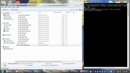

My error looks like this and this is the file i tried to run. i also tried nvflash.exe, but that didn't seem to do anything:
what am i doing wrong?

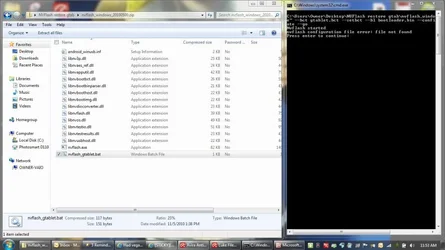

Aug 5, 2011
OK, i didn't realize that i had to combine the files from the two folders. i combined to one folder, then ran "nvflash_gtablet.bat", but now i am getting the following error:
any ideas now?!
(thanks)

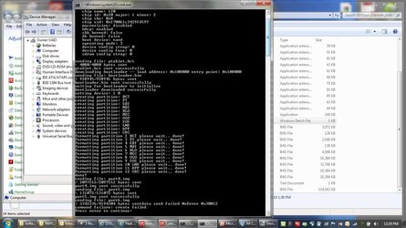

Aug 5, 2011
me again. i deleted all the installation files and downloaded them all again from scratch. that seemed to work to install the original operating system, but now my gtab just cycles through the 3 birds screen, to the gtablet screen, then to black (off), and then over and over and over.
i tried power button plus volume + so see if the previous owner had clockworkmod installed, but apparently not. i got the triangle with exclamation mark, and then powered itself off again.
any help on what i can do next? i read somewhere i'd have to get an sd card and install clockworkmod and repartition the gtab and then reinstall nvflash. would something like work (not that i'm looking forward to trying to figure that out, lol)?
thanks!
