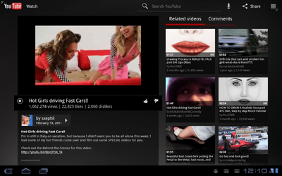

youtube can't play a hd video without constant buffering pauses it also seems to restart videos when I switch from portrait to landscape.

Since I currently have both a GB VTAB and an HC VTAB I can easily see what you are talking about where you state later in this thread: "youtube can't play a hd video without constant buffering pauses it also seems to restart videos when I switch from portrait to landscape."
Yes, only the HC VTAB will stop and restart when you change from portrait to landscape and that is very frustrating if you are watching a music video. I can also see that their fix for that is to lock it into landscape if you try to go fullscreen. Note I stated try to go full screen because you only end up with about 90% of full screen after giving up 9.5% of the screen to the disabled bezel buttons.

First back to a previous quote of yours where you state: "it also seems to restart videos when I switch from portrait to landscape" because I can easily prove the YouTube application being used by the Vizio HC VTAB1008 restarts playlists to the first video in the list when you change from portrait to landscape or the other way around.
All you have to do to see that for yourself is select a playlist and be sure to tap on "Play all" in the upper right hand corner. Then changing from one video in the playlist to another video in the playlist is done by swiping your finger to the left or right which is pretty cool but the problem is if you change the orientation of the HC Vizio Tablet you will also reset what video you are watching to the first one in the playlist.
And this will really upset you. If you upgrade the YouTube application on the Vizio GingerBread VTAB1008 you can also easily change which video you are watching in a playlist just by swiping your finger to the left or right and it will *not* reset to the first video in the playlist if you change the orientation of the tablet.

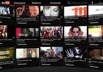

Yes, if users could see the latest YouTube app they just might want it over what Vizio provided us especially if they ever watch playlist and change the orientation of their tablet at the same time. EDIT I just found out you can "side load" the current youtube application and it appears to work a lot better than the Vizio YouTube application.

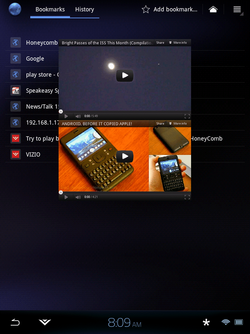

Now I have a funny one for you. I've been working on a web page with two videos that are about 5 minutes long and if I try to bookmark my own page I end up with this:
What you see above is what I call a bleed through because part of my web page has ended up in the bookmarks.
And the HC VTAB can not play either one of those videos all the way through but the GB VTAB can play both them all the way through.
On top of that, if you press the bookmark button while a video is playing all you have to do to get the video to play in the bookmarks is press the home key then select the Browser again.
