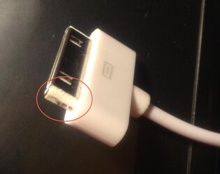

Hey thanks man, I ended up modifying my ipod cable, in other words, chipping off a small piece of the side cable. It fits perfect. I can charge, sync, upload to microsd card. It's weird. Before modifying the ipod cable, I ordered a samsung galaxy cable from ebay, at the price for 1.8$, didnt receive yet but supposedly they are compatible.

What small piece did you chip off? Could you describe what you did, and/or post a picture?

$apple cable mod by XDA.jpgThe left side as referenced in this post
Still works as an Apple cable. You can get some for $1 at Dollar Tree which makes carving more appealing.
