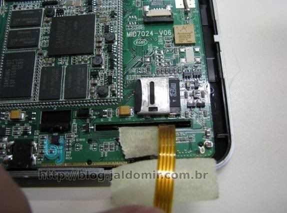

Kyros 7024 now have a different board so please be careful when upgrading your tablet. my tablet was bought a few weeks after release so its a 7025 board, newer 7024 now have 7024-v06 mark.
Image courtesy of mudknot2005
Image from Blog do Jaldo
