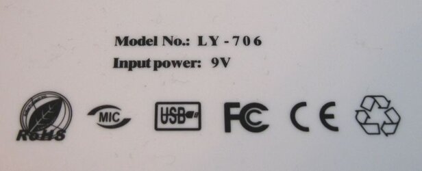

just received my mid 706 or ly 706 yesterday, which shall now be referred to as 706. it came with build 1.9, android version 1.6, very basic, no root...
... 1.7.4 firmware Download LY706.1.7.4.V1.7z ...
... 1.9.1 firmware rooted flytouch_1.9.1_fast_and_furious.zip ...
I also have a MID LY-706 (white backcover, black home key, one black power key and a black volume key at the side) - like whgarner specified it.
The "1.9.1 flytouch ROM" will not work! Flashing is possible, but it will hang at the first initial Android logo.
The "1.7.4 LY706 firwmare" will NOT restore a functional system! Flashable without any error, but hang at the initial boot logo. Grrr...
It seems that there are a lot of similar products called "LY-706" (clone of a clone of a clone ...) out in the market.
I have bricked my "LY-706" during these trials and think it's the best to DO NOT TOUCH a running Chinese system :):(:mad:
Look at the pictures to find out what device I have - and what device you shoud not to update ... :)

Nov 6, 2010
I have this device that matches these pictures and also can't find the firmware to fix a botched upgrade. Did anyone find this firmware? I don't see a link replying to this particular post
