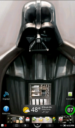

Tips for sizing and orientation. I went back and reread the other threads but don't believe a solution was ever posted, so here's how you do it.
1. Before long pressing a blank place on the screen put your nook in the proper orientation, portriat or landscape. Landscape is recommended.
2. Long press a blank spot on the screen.
a. In the default nook launcher you get a pop-up with the option to "Clean up this panel" or "Change wallpaper". Make sure the nook is in your choosen orientation before pressing the "Change wallpaper". Next choose the tab where your wallpaper is located "Wallpaper" or "Photo gallery".

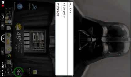

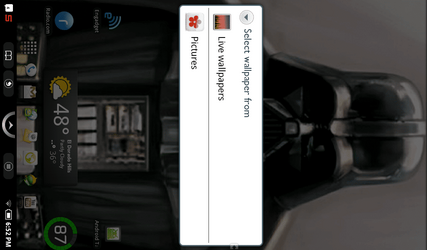

b. In Zeam launcher you get a pop-up with "Add item", "Set wallpaper" and "Preferences". Make sure the nook is in you choosen orientation before pressing "Set wallpaper". This brings up a choice of "Live wallpapers" or "Pictures". Choose "Pictures" and then choose the application you want to open the the pictures with (if you have not already selected a default).
3. Navigate to the picture you want to use for your wallpaper and tap it. If you have kept your nook in the prefered orientation the wallpaper selection box should appear in the same orientation. If it does not, choose "Discard" and return to step 1 ensuring you maintain the proper orientation, this is the key to filling as much of the home launcher as possible.

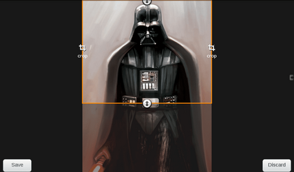

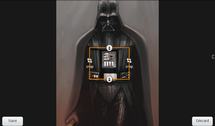

4. Long press on one of the orange lines of the selection box. "Crop" will appear on the left and right and arrows will appear on the top and bottom and it will allow you to resize the box by continuing to press and dragging the box larger or smaller. This is the key to getting the maximum amount of picture to be used. Once the selection box is propperly sized touch in the center of the box and drag it to the desired location.
5. When everything looks correct, touch "Save".
You have now correctly configured your wallpaper :)

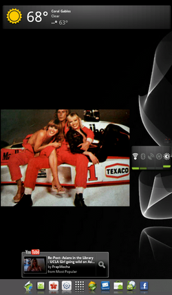

$11-03-24-1.pngHello LocalStain, I had a feeling you would come to my rescue again!
I got Dropbox few weeks ago when Darmeen told me how to post the screenshot from there. I'm going to figure out how to resize some pics I have there.In the meantime I found a.way to resize in the nook even though you can't really fit the screen. I 'm using the Desktop Visualizer. I would like something like that. that would allow me to place the pics whereverI want on the screen,even one on the top of the other,so I can do a sort of collage. Maybe there is an app like that.
This is what one can do with the visualizer.
