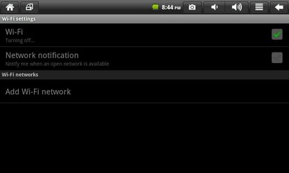

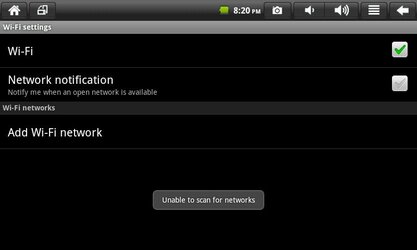

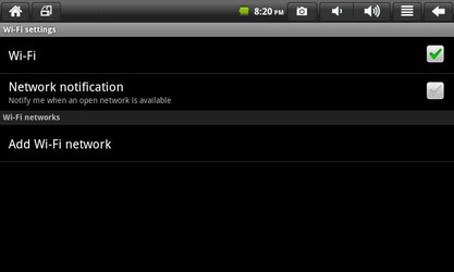

I'm having the same problem, and this was after updating to 2.2. It was working fine until I went to work and hooked up to the WiFi there. After my display went to sleep my WiFi turned off and would not restart. I knew this was gonna happen by reading other threads, no big deal reboot it. Wrong! Now when I boot it WiFi is disabled, turn it on and it seems to enable. It starts to scan for networks then gives me error unable to scan for networks, then the WiFi turns off. So I went through resources thread and updated the driver and set to 20 TxPower. Still no help. I'm hoping when I get home it will pick up on my network since it won't be searching 10+ different wireless
networks. The first picture is when I turned on WiFi, the second shows the error, and the last is where the WiFi turns off.

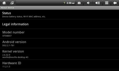

I also noticed my model number changed to SYTABEX7. This showed up after I flashed to beta4. Did I flash this thing wrong again? http://222.73.93.45/sysup.php?data=11.2.1.5&vcode=0 I just get the number 1 in return. Can some please tell me what am I going wrong?

jfbb43, The "Model number" is hard coded in the Settings.apk. On the first batch of EX7 it showed the wrong "Model number" confusing everyone so it was finally fixed in beta4.
