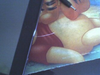

here is a mod i did that added great signal strength. as well as being able to pick up the neighbors wireless signals 5 houses away.
cut 3" wire and soldered the length to the small metal antenna on the inside. drilled a small hole in the side of the unit and pulled the wire through. The rear of the case as well as the back of the lcd is metal encased. getting a small length of wire on the outside of the unit increases the signal about 10 times. your mileage may vary. I have been able to pick up networks and use them as far as two hundred to three hundred feet.
