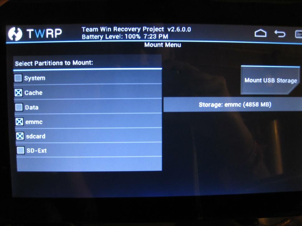

I don't know yet. For, I put everything on my 16gb SD. But, TWRP does not recognize the SD card. So, I did a full (not quick) FAT32 format of the card. Then, I put the files back on the card. The result was the same. After some research, I found that this is an issue with earlier versions or TWRP. Is this right? If so, how do I update the TWRP. If the version is not the problem, how do I resolve this?
I always appreciate your assistance.

Hmmm, are you using CT's original recovery (from here - Zenithink C97 zt-update rc3) or my 2gb data mod of it (from here - My Files)? Maybe I did something wrong? I don't think I did.... This was the latest twrp, as far as know...
From my C93, here are two photos from TWRP -
My sdcard shows up as sdcard -
These are my mounts:

I looked in the sd-ext folder for the update files on the SD card; which was empty. From inexperience, I thought the card wasn't being read. From your above image, I tried again and found sdcard/zt-update and "wha-la", all the update files appeared. I did the update and it went smooth. Thank you so much! But if I would have looked around more, I would have found the zt-update. Then, I wouldn't have bothered you. My bad! Please excuse my inexperience.
