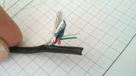

Since the only source I've found for a USB-to-3.2mm (or 3.0mm) tip sells for $18 plus shipping FOR JUST THE CORD, I've decided to DIY it.
I cut into the USB-to-iPad cord that came with this Kensington car charger I bought expecting to see two wires. Instead, it has four. Red, Green, White, and uncontained between a shielding sheath and the outer insulation. Great.
Anyone know which wires are the two I need to soldier onto the Radio Shack Enercell "G" tip I'm planning to use?

I just used one of the many USB cables I havet in the drawer with the USB-A plug on one end. I cut off the other end and found fgour wires inside: grean, white, red and black. You us the red & black for power, and the green & white is for data, so I cut off those. Check first to make sure, and check the polarity after you do the soldering.
I also used the Adaptaplug #G, not the Enercell one.
