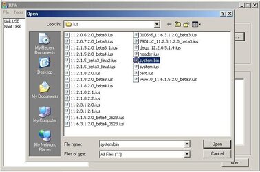

    You'll need to use the InfoTM Update Wrap tools "IUW.exe Version 1.2" attached. Even though the first update file system.bin has a .bin extension it is still a "update wrap" (*.ius) file, just use the drop down and select "All Files (*.*)".
    Use either Step 4a: Using USB cable & OTG port or Step 4: microSD card in http://www.androidtablets.net/forum...date-synet7lp-sytabex7-android-2-2-froyo.html or see the "official" Instructions in http://www.androidtablets.net/forum/infotmic-based/17274-introduction-iuw-burning-tools.html.

    Once this update is complete, check "hwver" again and post back results as that update is either DG2.01 or DG2.02 and will still be Android 2.1 "Eclair" and the Automatic update process will not work so to go to Froyo you'll need to repeat the steps with the next appropriate update file.
    Good luck and waiting to see how it goes!
