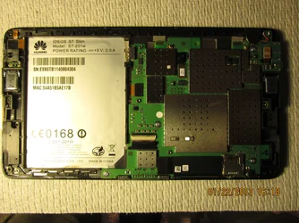

    New tot his forum, so have some patience, I tried to remove the rubber from the sim slot on the S7 slim, bought at Bestbuy. (Am back in Europe now) Found out that, yes it does facilitate sim, as my old Ideos 7 does. Problem is, that the screen is off with regard to colours, so I much have touched something prodding around in it. The question, does anyone know or can tell me how to open up an Ideos 7 slim without wrecking it. The six screws at the back with the lit removed do not do the job and I do not want to start wrecking it further if possible,

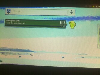

    Now your screen looks as if it runs i 8 or perhaps in 16 color mode .
    If yes than i have the exact same problem and yes i ended up this way while trying to remove the rubber thing from the SIM slot.

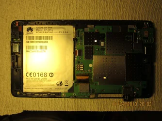

    This is what it looks now
    On the second pic

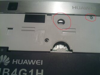

    Upper left in the red circle is the 6th screw covered with a white sticker or some paint. just above the SIM slot in the hole (red circle in the middle) is a similar larger sticker.
    I removed both these stickers while searching for a way to get to the SIM slot and
    upon restart the screen was as it is on the first pic.
    Have you removed/damaged the stickers?

    1. Yes that is exactly what it looks like, only in darker shades in my case. I noticed that I may have knocked a very small component of the main board, will try to show that with pictures in a few days time.
    2. And I did unscrew the screw you point at, voiding the warranty
    3. I will also make a picture of the opened tablet, as far as I dare to go without fully wrecking the thing. It may be showing the internal SD to experts

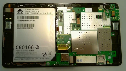

    1. Attached pictures of my wreck, one original, the other shows in a yellow circle where something came of, I would need a macro lens to show it, but it is silverish on one side, black on the other and seems to have been connecting the points located in a square shown in the circle
    2. With regard to the sticker, no sticker left on mine as far as I can see it.
    3. You can open it up as I did, after unscrewing all the points, by carefully pulling the two back covers of. The pull at the speaker location on the white aft side where the volume buttom sits. Once the side is opened up with a gap, you can move around the entire edge with a screw driver, rotating it, again carefully before you know it you may cause damage.
    4. Yes my screen also looks like that.
    5. The ****ty thing is that it was all caused by no response from the screen anymore, then considering that I may have bent something by removing the rubber, whilst checking with a pin I damaged the part. The response is back with a rom update. It's always the devil with his schemes.

    No luck with soldering sim contact.

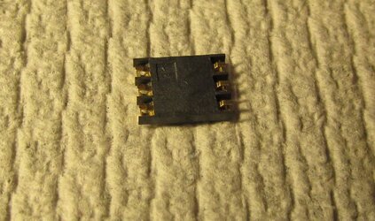

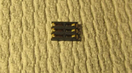

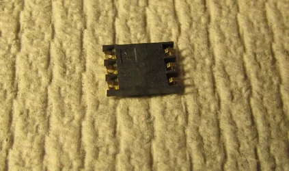

    Opened my S7 Slim 201w and carefully removed the black form sim shaped piece from the back cover. (The only way it should be removed is with the back cover off. Digging around on top the circuit board is a mistake). Soldered a sim contact (see photos). And tried the stock rom for the 201u and no success. The sim card was not detected. Flashed be the 10-20121122-experimental-asturel back un my tablet still no sim detected. I even tried to make an emergency call but apparently the radio is not on in the 201w. It probably is not entirely software but perhaps some hardware left off or unconnected.
    So I posted pictures for anyone who want to pick up where I stopped.
    Link to Fcc page: https://apps.fcc.gov/oetcf/eas/repo...e=N&application_id=181816&fcc_id='QISS7-201W'
