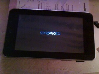

Hey all i own a
Rockchip 2808 Dual Core Android Tablet
and when i boot it gets passed the picture of the robot and then i get the ANDROID wrighting in the middle of the screen and it never gets past this -.- theres a picture attached. The man i bought it off said to flash it and i have no idea how to do this ive tried verious tutorials but they use one of thouse USB to micro SD things and i havent got one ='[ but i do have the usb cable for the tablet =D please help :) $epad.jpg

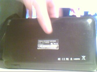

Look for a tiny push button (flush) on the back of you tablet, press this for a Hard reboot then wait for a full boot up.
i found it :) it was the evilest hidden little rubber button ive tried it 3 times it restarts and gets stuck at exactly the same point again ):
