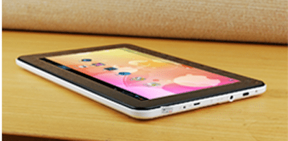

I have a tablet here I will give you as much info on it as possible, I'm pretty sure its a Chinese brad tablet
Screen size : 9"
Operating system : Android 4.0.4
Cpu : Cortex A8 1.5GHz, All Winner A13
Ram : 512M DDR3
Memory : 4GB + SD card slot
Model Number : KB901
Kernel version : 3.0.8+
Front and rear camera
Across the top you have, Power Button, Headphone jack, Mic, SD card slot, Usb Port, Power jack
Left hand side you have, Home button, Volume keys
I have the build number here if it is needed
the research I have done on this tablet i think the brand is "lonshion" but not 100% sure on that one
If anymore more info is needed just let me know and I'll see what i can find
what I'm wondering is if anyone can confirm the brand, and if this tablet is rootable and what i need to do to root it
It is my first tablet and i would hate to brick it..... I do have a HTC phone that i rooted so I know a little about it but not a hell of alot
also the other thing is... when I plug the charger in, the touchscreen goes a little nuts when I touch it, is that common with these tablets? and can it be fixed?
here is a pic of it... if you need a different view just let me know and i will take and upload them
thanks in advance

Specs are just like any A13, most likely already kernel rooted.
charger touch screen issue is normal no fix, sometimes a new rom will lessen the effects sometimes it wont.
for root download superuser from market and update it.
if this doesn't work you need to install adb drivers.
http://www.unlockroot.com/unlockroot.php used to carry a huge list of model numbers and devices they were associated with, but the link seems to be temporarily broken...

you can use any A13 Rom as long as you know how to modify them to suite your device. If you want a copy of the bootloader simply dump it.
with any tablet you should install adb and back up your tablet before you make any modifications to it.
You need adb installed and working.
adb shell
mkdir /sdcard/dump
cat /dev/block/nandc > /sdcard/dump/boot.img
cat /dev/block/nanda > /sdcard/dump/bootloader.img
cat /dev/block/nandg > /sdcard/dump/recovery.img
busybox tar -cvf /sdcard/dump/KB901_system.tar /system
