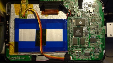

Just in case anyone is interested - here's a pic of the unit cracked open. Seems to use two chinaphone batteries wired in serial.
