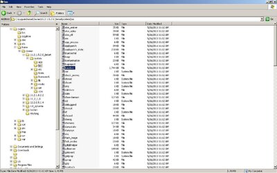

An inspection of the extracted system.img (picture below) from the 11.2.1.5.2.0_beta4.ius update file, shows busybox in the /system/bin folder, so it should have been installed with that update.
However, the manual method to update Busybox posted in the http://www.androidtablets.net/forum...tom-sylvania-rom-development-5.html#post93871 thread installs it in /system/xbin with specific permissions to allow it to execute. It may be another one of the issues with these beta updates.
Caution: Many of the commands in /system/bin and /system/xbin can be run with root permissions.
