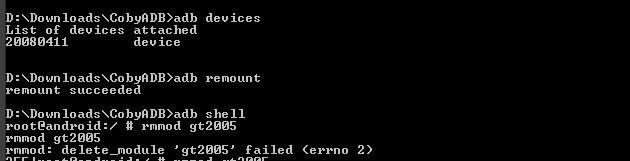

$err.webp after that tried the previous one
did you factory reset after installing kernel?
I don't know what the problem is, your drivers are loaded so they should be working.
is touch working on your cm9 install? have you flash cm9 boot.img to make sure cm9 install is still working?
