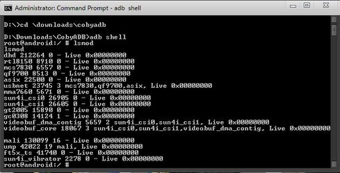

adb shell
lsmod

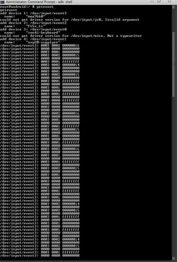

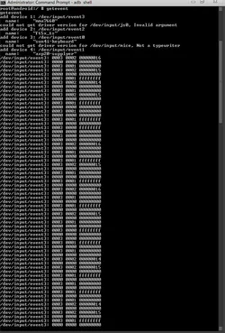

getevent
post output
$getevent.webphereyah go
your touch screen drivers are loaded

But what does the error at getevent tell Invalid argument for "mma7660"?
