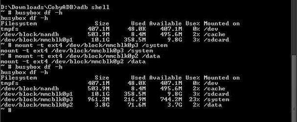

does the same thing black screen. hmmm must /data also be mounted when installing?
you need to delete /data once you flash new kernel.
in cwm recovery

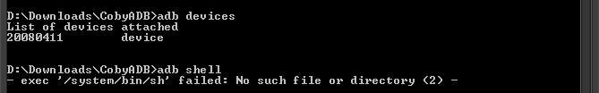

adb shell
mount -t ext4 /dev/block/mmcblk0p2 /data
rm -r /data/*
rm -r /cache/*
