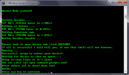

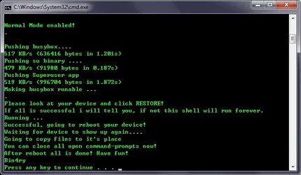

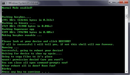

https://www.dropbox.com/s/gqjukh6nhkf5ybu/root.txt this my attempts at rooting my 7036. I found the C error fixed it, but still running into the Are you root? message once it finishes running. Any thoughts?

I got "more than 1 device and emulator" error, and " 'C' is not recognized as an internal or external command".
I rooted a android phone before, that's probably the reason for one of the error.
Can I get some info on how to fix these problems?
no within the root utility filestructure on your pc
mv ../stuff/install/busybox ../stuff/busybox
judging by your screencap you there is another error with in the script
**** here dl this https://www.dropbox.com/s/kbhyntbfddb36qp/RunMe.bat and replace the .bat in you utility directory..... it looks like the c error is because it is supposed to be a shell command but busybox was never pushed.
This batch still throws the C is not found error, it's near the bottom
