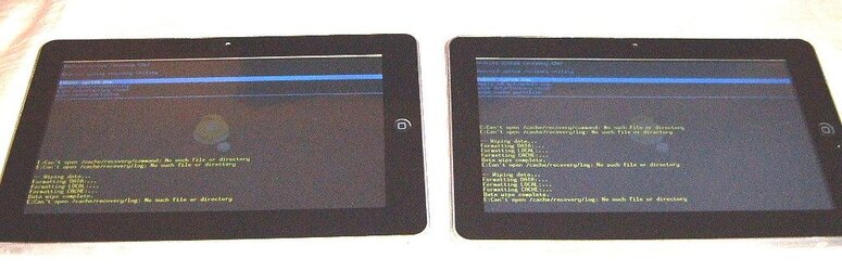

After a successful install (BWO the IUW 1.0 'expert mode') on the 'new-broken' pad, I was able to get it to install on the 'old-memory-broken' pad too... as seen below:
IF ONLY it had the ability to WIPE the /system partition too...
THAT might get my original pad working again.
:cool:
Lucky that it uses the buttons (VOL+/-, MENU) to do things... as the touchscreen on the 2nd/new pad doesnt work (seems to be a hardware issue on the main board :mad:)...
After it loaded I attempted to do a clockwork update (2.5.? that I got from 'somewhere') that wouldnt do anything... so the <2e> version was reloaded... again successfully!
I allowed it to do the full data wipe a few times, and I think it has cleaned up the /local partition somewhat... but cannot say for sure as /system is still 'bad'...
BUT IT DOES WORK on the wwe101 v3.5 system boards!
As tuzzz said... power-up with <HOME> held down and release <PWR>...
release <HOME> once TUX shows up... it will give the WOWPAD green screen and then the screen seen in the pics below.
THANKS AGAIN TUZZZ!!!
