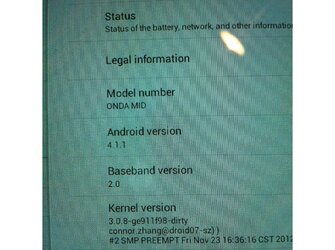

Update: Jelly Bean installed! (See Attached). Rooted, Superuser and Rootexplorer, Google Play installed, and all seem to be working at this point. I think everything is working. Web browsing seems much smoother and faster. Good WiFi. Just working on removing the Chinese apps, having a few issues trying to get them to leave. To everyone that worked on this, particularly iiDiabolusZz, a big thanks. I was a little nervous, but dove in. I did have one unexpected issue. My battery was completely charged when I started the install process. After the white android, the green android and progress bar appeared, about half way through, the display disappeared and the Low Battery icon appeared. I turned of the tablet, connected to the charger, waited a few minutes and restarted the tablet.
I really thought I was in trouble. Table restarted and completed the installation proceeded with rooting, Superuser installed, but had install Rootexplorer as noted in the * section of the instructions.
Thanks Again!
