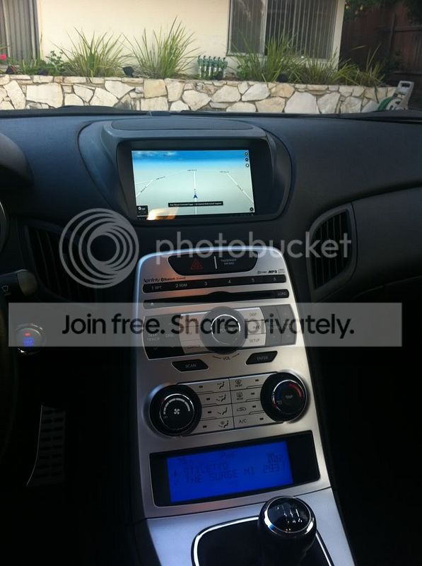

I have recently installed an Acer A100 tablet into my car to use for GPS navigation which went well the very first day using NAVFree USA. The second day trying to use the navigation it gives the "poor GPS" signal and NEVER does find my location...What a bummer.
I am running this tablet in "offline" mode not connected to wifi or using any data just purely off the GPS signals. I have also installed AutomateIt to automate some tasks
- When power is connected: Airplane mode OFF, Wifi OFF, Bluetooth ON
- When power is disconnected: Airplane mode ON, Bluetooth OFF, Screen sleep after 30 seconds.
I cannot for the life of me get it to work again. I have tried downloading other apps and it seems they too cannot find my location via the GPS signal either. I have also ended the tasks running and tried reinstalling. I've also tried rebooting the device.
