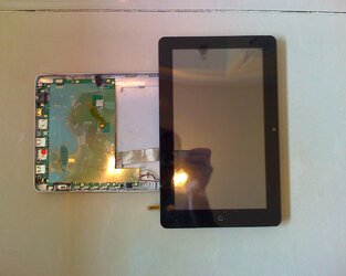

hi can anyone help iin identifying this tablet please, its 10 inch, has 2 full size USB, 2 TF card slots, mini HDMI, network, headphone and DC on one side and on top has wifi on/off switch, home, menu, +/- and power switch also has connection for GPS with 2 speakers, it has an infotmetic splash screen i cant boot so dont know anymore it does have what appears to be a 8.4v battery @3800ma,
help much appreciated
The REAL info is on the other side... like the board name (wwe10, I suspect).
If you havent wiped out the original software, the <HOME><BACK><PWR> combo will get you to a factory reset...
Then you do the <HOME><BACK> again (or just release/repress one of them while holding down the other one).
Anyway,
256Mb RAM,
2Gb flash 'HD',
InfotMIC IPX210 ARM processor, avg 800mhz...
:D
