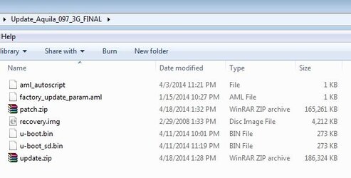

I have tablet which is (cmx aquila 097-1061) it is 3g-bt Bluetooth tablet which is stuck at bootloop. running 4.1 jelly bean
At official website only update of firmware available http://cmx.at/de/produkte/nicht-mehr-erhältlich/aquila-097-1016-3g-bt
I found most similar tablet onda v811d and tried most frimware of onda v811d using amlogic flash tool but failed-to start my device i think bec onda v811d is not 3g and Bluetooth enabled
I tried Amlogic rescue sd card which works fine but my tablet is still at same position and stuck at bootloop
my tablet config
cmx aquila 097-1061 3g + bt
aml8726-mx 1.5ghz dual core
1 gb ram
16gb internal mem
3g
Bluetooth
if u can help me to bring back tablet to life thanks
