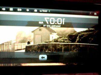

i need help ... it wont go past the slide to unlock screen
mikeothe2
Jul 16, 2011
I just got a Sylvania Tablets 7 in with 2.2 off some one, and it was working fine until i started installing apps , now it wont go pass the slide to unlock screen.. $Photo on 7-16-11 at 10.07 AM.webp
I tried using a mouse and keyboard but it did now work .I also tried to reset it but i get "No recovery image is found, try recover from SD" . what sould i do?
I just got a Sylvania Tablets 7 in with 2.2 off some one, and it was working fine until i started installing apps , now it wont go pass the slide to unlock screen.. View attachment 3207

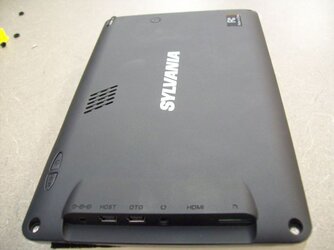

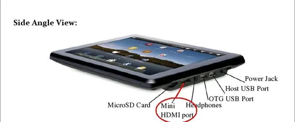

Without the Hardware ID "hwver" using the incorrect InfoTM Update Wrap (.ius) file may cause irreparable damage (brick) to the device.
Sylvania tablets WITH "Mini HDMI port" (pictured below) have been identified as 11.2.0.5, 11.2.0.6, 11.2.0.7 and 11.2.1.8. The most common have been 11.2.0.6 and 11.2.1.8.
WITHOUT "Mini HDMI port" has been identified at the SYTABEX7 Hardware ID "hwver=11.2.1.5".
Depending on whether the tablet has or does not have a "Mini HDMI port" you can try to apply an update file however you risk irreparable damage to the device resulting in a brick.
