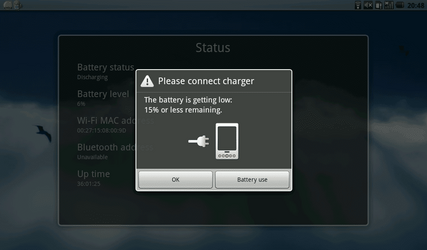

Another disappointment is the supplied charger - cheap and nasty, which is a shame as I am pleased (not to mentioned surprised) at the very good build quality of the table itself. Have tried a number of alternative chargers - the first one ($3) burnt out after around 40 minutes. The second one (Veho - $6) looks very nice, appears to be of good quality but simply didn't work. Now looking at more upmarket chargers around $20.
You might want to check with supplier first. Regular USB chargers won't work. It might be some kind of different pin out. You don't want to damage the device by plugging in the wrong charger.
Is the manufacturer original charger still working? Does it have a part number for part cross reference?
With usb chargers the pin outs are standard so there no chance of messing stuff up. They'll all 5volts which is the voltage of a usb device. The important thing with the kinpad powercharger is that it's 2amps. 2amps is more than than computer usb ports which might explain why you can't charge the kinpad via computer. A charger can have more more than 2amps but not less. Too low of amps the device won't charge at all or the amp draw will be too much and burn the adapter out. The other issue is that a lot of usb adapters are the smart type that provides data to the device and vice versa. These type dont work with the kinpad which means that higher end power supplies designed for devices like an iphone may not work. As an aside the iphone cable works as a substite kinpad usb cable.
In other words all you really need is a plain, inexpensive usb adapter that can provide 2 amps or more.
Yes the original charger's still working and now we know why the replacement 1 amp charger burnt out!
