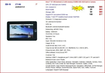

(catching up on this) I got mine back and they did nothing. They returned the same units, but with 2.2 on it. Everything seems to work...ok. Not great, but ok. It's a $99 tablet, I dont expect much from it, it is just a $100 toy for playing Angry Birds on and checking email and Facebook. The thing that gripes my arse is it keeps dropping WIFI now and will not reconnect. I have to reboot it and wait. I have written Jeffrey @ DigitalGadgets and he gave me the typical speil that you would get from any support desk... checking the OBVIOUS. They dont even know there is an upgraded driver for the WIFI unit in their product. I have been looking at all of the available tablets on the market and I have decided that I wasted my money on this one. I will still use it for the above tasks, but I dont expect anything else from it. I am going to make a couple of hardware changes (I've already cracked it open and started Id'ing components). The first on my list is a USUABLE audio plug. The WORLD uses a 3.5mm jack and we got stuck with a 2.5 and that is just sad. Wonder what they saved? 1/100th of a cent? Anyhow, in my searches I have found direct vendors that will sell you the same basic tablet WITH all of the good stuff for $85 plus shipping. I am sure it has it quirks like ours do and it doesnt have GPS, but with the BT, I could at least connect to my Delorme Earthmate or something...

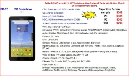

Or go all out and get this one...
Hmmmm.... don't know... that $85 one looks nice, specially compared to this one... how much is shipping on it though? Wonder how similar it is to the tabex7? Wonder if the case could be cracked and have the GPS added to it... Not really hardcore about the GPS part, but if it could be added in... with a few other tweaks, it could become an in car computer. GPS NAV and radio usage...
