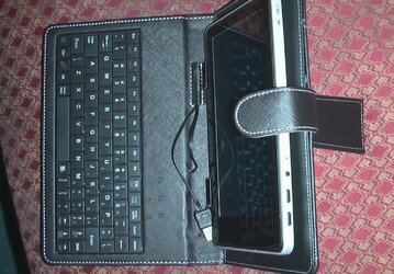

My woPad and tablet holder w/ mini usb keyboard
yeyeom
Jan 17, 2011
just bought my android tablet from ********** and leather case, love them!!!
Hi! I got the same setup as pictured above (from Merimobiles). The Wopad is a decent little tablet! However, it does not recognize the Keyboard no matter what I try. I have sent an email to the supplier about this and I am waiting for an answer.

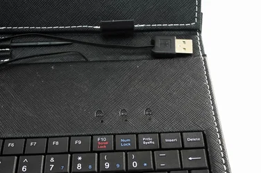

The Keyboard seems to have three little LEDs - is that correct? Does anything light up when you plug the Keyboard into the Wopad? Mine stays dark.
Do you have any suggestions on how to get these pieces to play together? Thanks in advance for any and all ideas.

1) In the above instructions, the "Case/Keyboard" cable terminates in a full-width USB plug. In my case, the termination is a MINI-PLUG. There are two USB ports on the Wopad. It may be that "host mode" only controls the full-width port. This may be a problem.
2) When I go to Settings/"Language & keyboard" the option to turn the on-screen keyboard off - as shown in the above video instructions - is not there! Even if I select "Android Keyboard" there is no such option.
So I may have received the wrong case, the wrong firmware, or both. This is perplexing.
