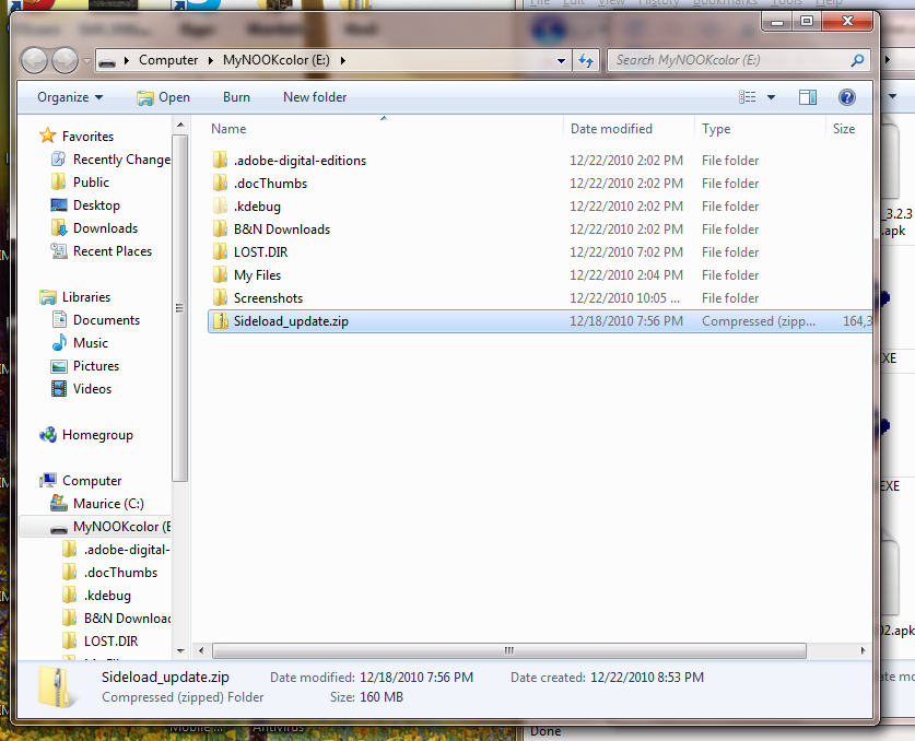

-Copy update zip to root directory (see pic)

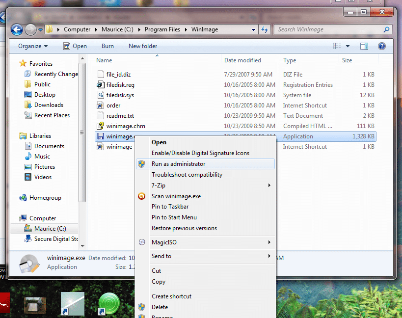

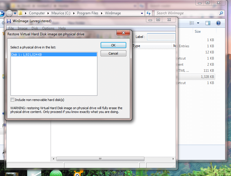

-Right click on winimage.exe and run as administrator (if not, your SD card will not be recognized).

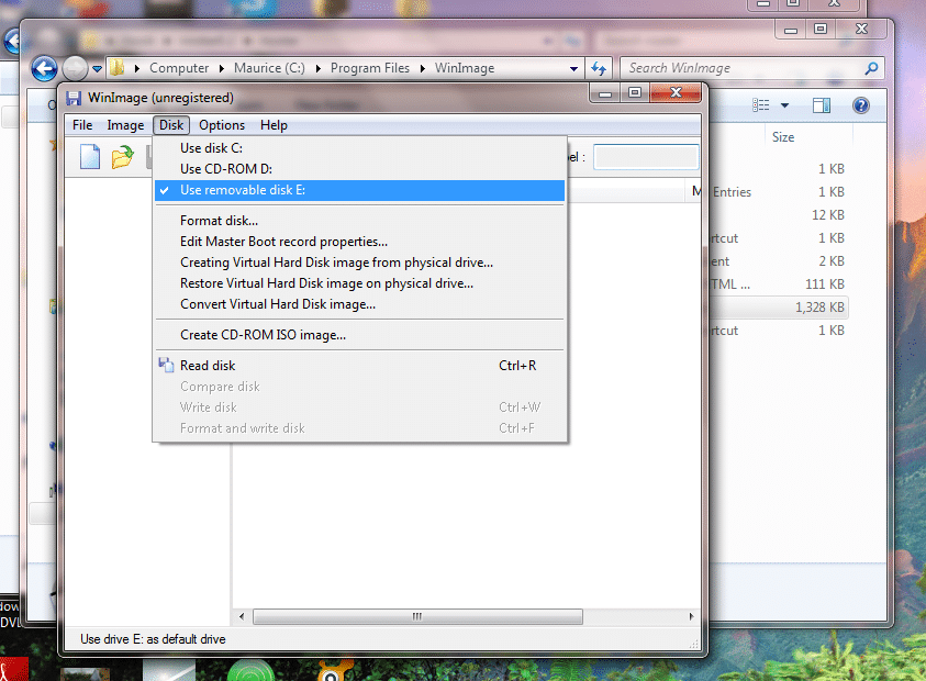

-Go to Disk and select your sd card (Use removable disk)

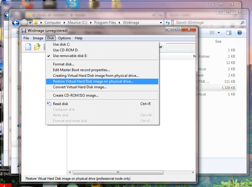

-Then select "Restore virtual hard disk..."
-Again select your sd card

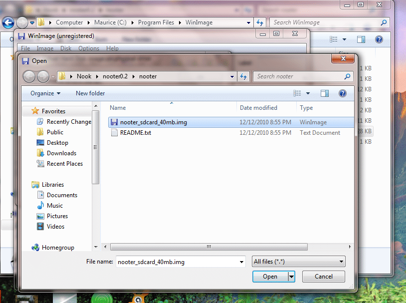

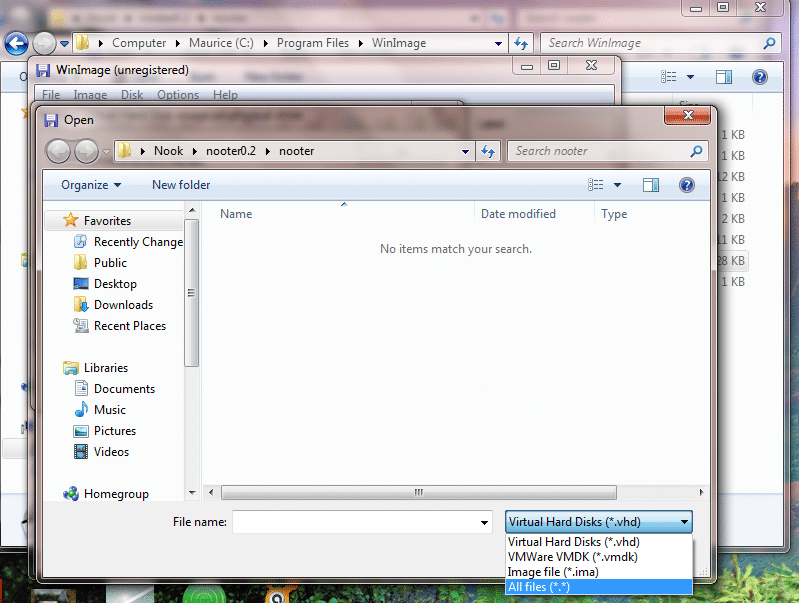

-A window will pop up asking for the location of nooter02 image (manual method), use auto nooter image if you are using the auto method.
-Use pull down to see all files.
-Select image file

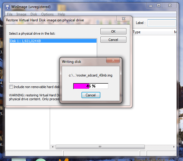

-Winimage will ask you if you want to create this image, press yes.

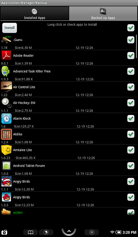

Restoring apps from backup
Here is how you restore your apps after update and re-rooting using ASTRO.
-Use adb to install ASTRO apk.
-Insert your sd card with your backed up apks.

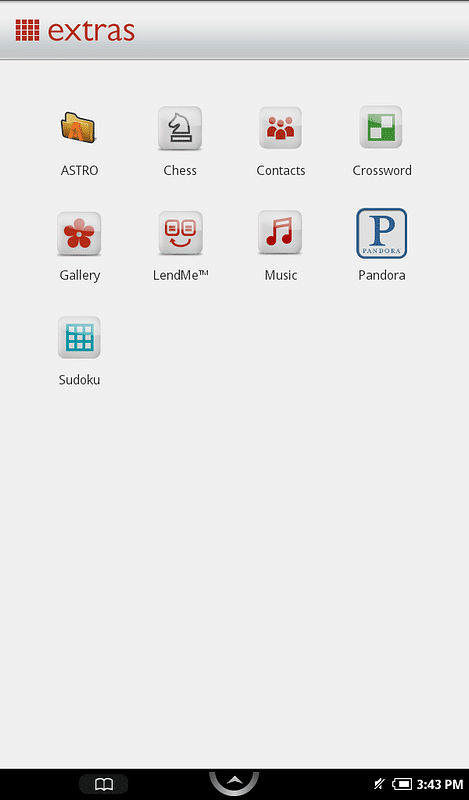

-Unplug usb cable and unlock home screen.
-Go to "Extras" and you should see ASTRO installed to your NC.

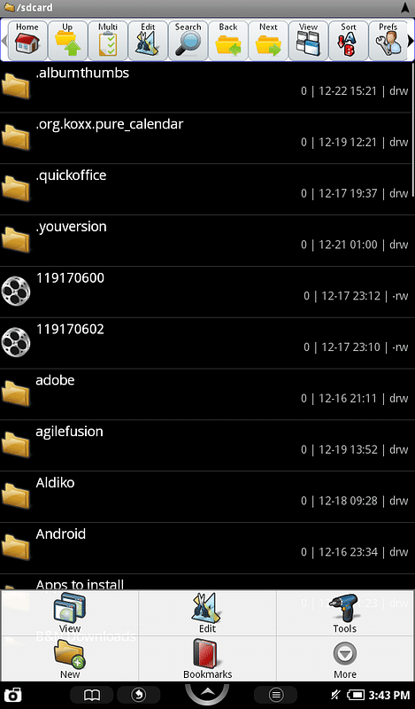

-Open ASTRO.
-Press setting button to pull up ASTRO menu.

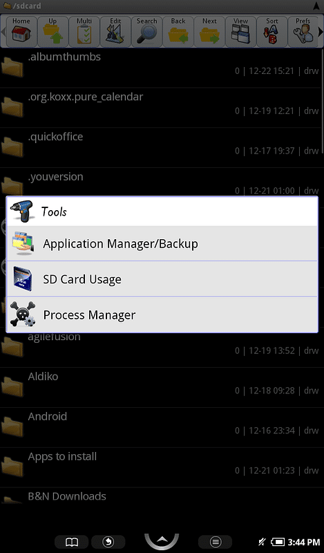

-Press Tools button.

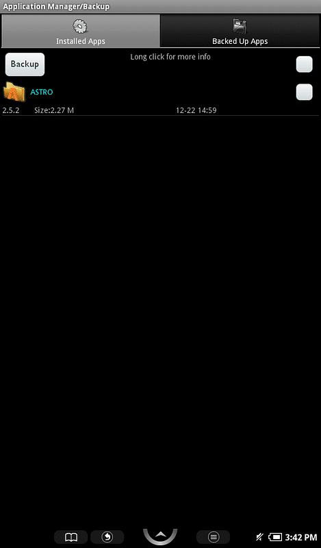

-Press Application Manager and Backup.
-You will see only ASTRO is installed.
-Press "Backed Up Apps"
-Check all apps you would like to retore (re-install)
-Press install

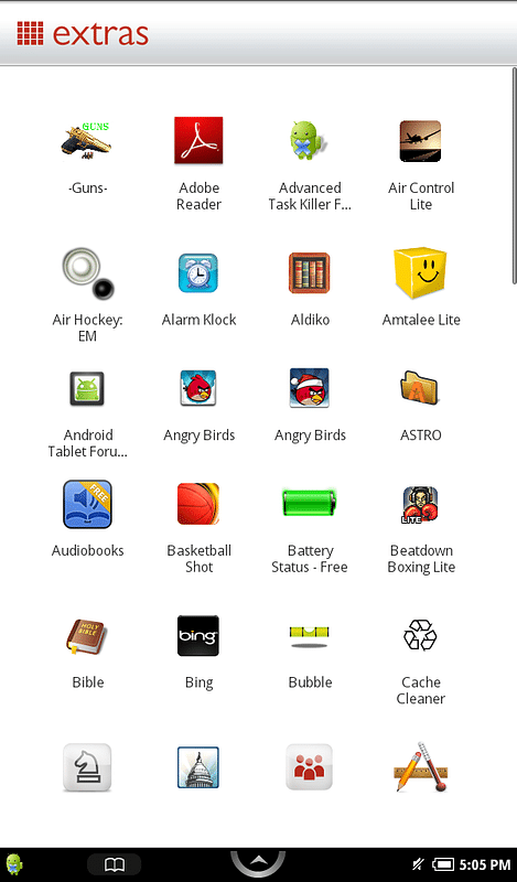

-After all apps install, reboot
-Then go back into "Extras" to see your restored apps.
-Enjoy.
