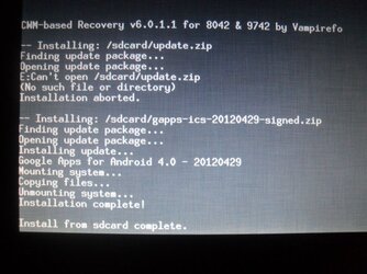

this is how it looked like when i boot into recovery and installed the GAPPS package.. :)
is this correct?:confused:

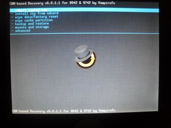

That's the stock recovery. ClockworkMod recoveries look similar, being based on the stock recovery, but are clearly marked as being ClockworkMod in the lower left corner. Therefore you need to install ClockworkMod recovery.
this time i'm sure i have CWM installed properly.. :)
i renamed the images as "cwm_recover.img.img" and i think that messed it all up..
phew...but with the GAPSS properly installed, am not sure about that.. :D
