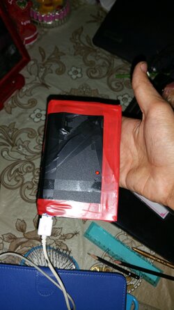

i have built a perfect phone charger....
I read and tried every thinv and every way to build usb phone charger that charge my phone fast and can be recharge ....i tried the lm7805 voltage regulater in every way but with no avail. ..i mean it's not perfect....
so i start to build phone charger by another way...
I've an old laptop battery. ..i toakeit and opened it. ..i found 6 li-ion batteries with 11 volts ...these are chargable ....also i bought a phone car charger with 2500 mA...i opened its case and i toake the board and i connected it with 11v li-ion batteries and test it....it was very fast charging and the voltage of the batteries was get down very slowly so this is perfect. ...then i get a female laptop charging connector and connect it with the batteries with led and a diod and start charge the batteries with laptop charger wich gives 18v....it's take 2 hours to full the batteries. ...and in the end i used the batteries case and finish it....it is really perfect. ..
the case is square. ..acer laptop battery
