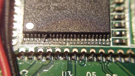

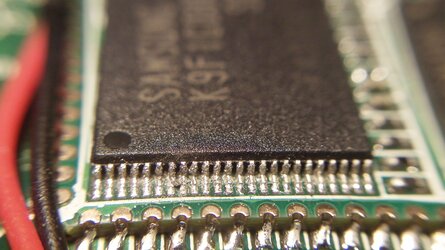

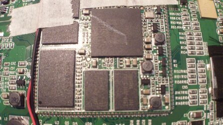

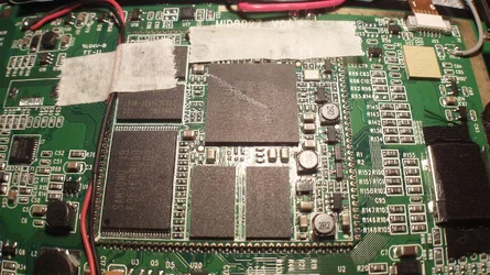

Can you post a pic of the internal board showing the smdkv210 module (the one with the Samsung CPU)?
After trying too many times I think the 7th pin became twisted - second photo - I then managed to almost put it back in place - third photo.
Ugh, it looks bad... =(
You don't need to short the pins anymore once the tablet is no more hard-bricked. If it stays on after releasing the power button, you should be able to install any (compatible) ROM.
I don't see any chips related to the touch screen. Should be one next to the flat cable that comes from the touchpanel. If you can identify what model/brand is used, then you can try a cooked ROM for it.
