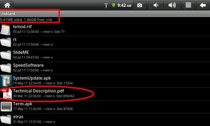

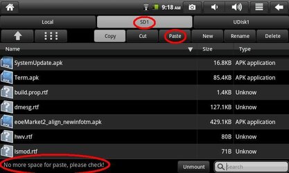

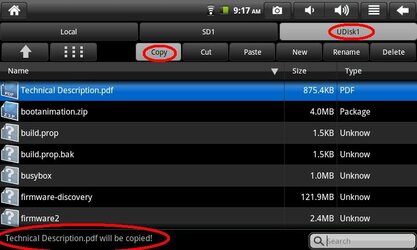

Performing a copy and paste using Root Explorer of the same .pdf file below worked as expected where using "My Pad" pictured below failed as you described.
Failed to paste to SD.
File copied properly between /Udisk (USB) and /sdcard (microSD) using Root Explorer.
Root Explorer and other more fully featured file explorers properly display the file icons and additional file information.
