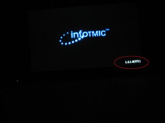

Can you identify the Hardware ID "hwver" of the tablet either using adb or Android Terminal Emulator if it is not displayed on the initial boot screen as pictured below?
Code:
C:\>adb shell
# cat /proc/cmdline
cat /proc/cmdline
console=ttySAC3,115200 androidboot.mode=normal bmagic=0xeefffff1 hwver=[B]??[/B].[B]??[/B].[B]??[/B].[B]??[/B]

V2.3 is just a version of firmware not Android. Firmware for these tablets usually consists of a few images including U0 "u-boot-nand.bin", RD "ramdisk.img", LK "Linux Kernal" also referenced as uImage, userdata.img, and system.img or zSYS.img "SYSBACK". To identify the latest version available you'll need to identify the Hardware Id "hwver" http://www.androidtablets.net/forum...-infotmic-hardware-ids-hwver-updates-ius.html then Search the forum for updates to that specific hardware. What is the Hardware Id "hwver" of your tablet?
In terms of root there are at two applications commonly referenced for InfoTMIC power tablets. A quick "Search Forum" will generate a list of useful posts.
