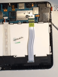

To test it we took the back off this tablet and another spare one and connected the spare ribbon to the display of the failed one.
When doing this the spare tablets display was clearly visible on the previously dim one but not the other way around.
Just to confirm, we set the brightness very low on the spare and restarted it just to see what happens and when it boots up the Samsung logo is full brightness and only goes dim after it fully loads, the tablet in question is always dim.
It is starting to look like a hardware failure bit I cant imagine what component would determine the brightness of the screen bearing in mind the screen works fine when connected to the spare.

We just plugged it into the connection shown below and up came the display from the spare. Just tried a few random things...
