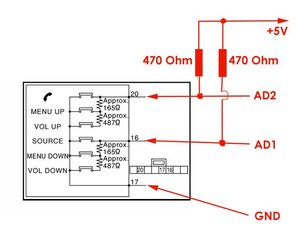

Hi. Here is the video, demonstrating steering wheel controls on my Nissan.
You need to look at the electric circuit diagram of your car and find the type of steering wheel control and wire layout.
If it uses CAN Bus steering wheel controls, i don`t know if your 777 will work. Propably it won`t.
If it has a resistive keys - 777 will work. You need to connect GND to GND wire of the steering wheel keys, Steering wheel control has 1 or 2 outputs depending on car model. Connect Ad1 and Ad2 to the outputs. That is all. Now it should work. However, it may recognize not all the keys because they give similar measuring results. In this case you need to add extra 500 Ohm resistor between each AD line and +5V.
Resistive keys control system is just a set of different resistors. 777 measures resistance (actually - voltage) between GND and ADx and recognizes which key is pressed.
But anyways, i recommend to download and study service manual for your car first to avoid possible problems.
There is also one more type of steering wheel controls, but i have no idea how it works and how to connect 777.

I cannot get any wiring info for my car so I mesure the resistance changes
with a meter of the 3 remaining wires from original harness and 2 registered.
Connected AD1 and GND to them directly and managed to get 4 out of 6 buttons working.
I will try again when I get myself a resistor to connect to 5V and the AD1.
Hi, in my car steering wheel controls wiring diagram is like this :
There are 6 buttons in 2 groups. 2 signal lines. Without resistors only 4 buttons work. With resistors - all 6.
