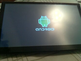

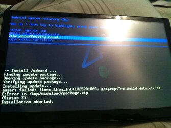

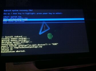

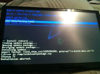

hello there everyone, well i have had my dm7033 for a few months and most things seemed to be ok but, i got the itch and had to have a mess and now i have a tablet that doesnt boot past the android screen.
so i figured i could just reinstall the android os... after much reading of this thread i found a download for the android OS with clear instructions on how to boot into recovery mode and install using and update.zip.
but for some reson my install process throws up an error :(
does anyone have any advice?
many thanks
ambrsia.
Hey ambrisa i have the same issue
Any one has the original firmware for the tablet??
any one who was able to install cwm, can you make a backup and post it?
Please
Hey ambrisa
do you have adb?? are you rooted??
if not download superoneclick and do it
then fastboot erase system
reboot into recovery
and apply this update
https://www.dropbox.com/home?select=update.zip
that's how i got mine to boot!
