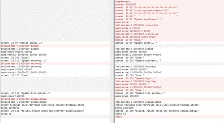

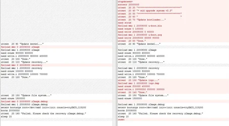

i really dont know why my camera is still working while other's dont, even if i try different version 2.2 or 2.3 of android from different rom makers. Only difference may be that i always use TILEG's utscript so something is not being erased in my NAND Memory. Whenever i test a new firmware i always replaced the default utscript.
Left screen is tileg's version
