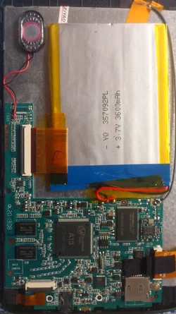

Note: picture of "motherboard" attached

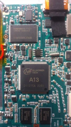

Hey there friend! I also am no expert but it sounds to me like you ended up putting your tablet into a boot loop Im not familiar with that brand of tablet but from looking at the images you posted the board looks almost the same as mines and you have the same processor...My tablet had a similar problem when i was fiddling with the Firmware and ended up in a boot loop i searched every where for a factory but couldn't find any but after opening mines up and seaching for the board number i was able to find a link to a compatible firmware and used livewire to flash it to my device now...... Im not sure what board you have but you can give searching for the inet-86vs-rev01 board and see cause it looks exactly like mines again i used livewire to flash mine and perhaps you could do the same for yours

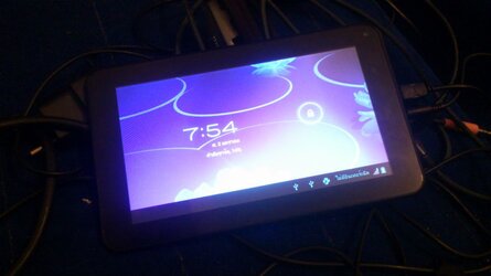

this is a capture from the tab with the t730-mainboard-v6.2 wifi+bt.img
No problem that tablet looks exactly like mines so with luck the rom you downloaded should work....the reason the touch screen isnt working is because the previous rom you had didnt have the correct drivers as a result it doesnt work but if the Inet86vsrev10 rom is the correct one you will have no issues there...at least that is how it went for me but if your still having problems post again and i will try to help
