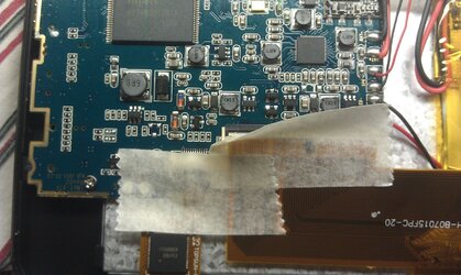

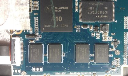

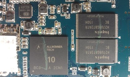

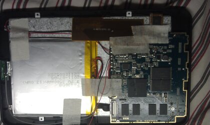

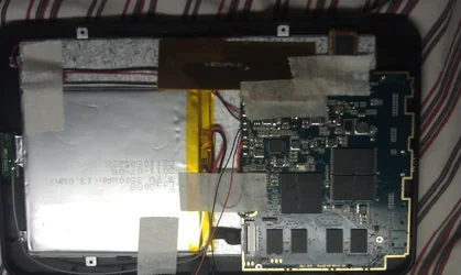

Alright guys, I was bored and popped the back cover off of my tab, and now I have a few pictures of what I discovered (chinatab pr0n if you will). :p
I didn't bother removing the mainboard from where it is mounted, as I really don't want to break my tab (the use of masking tape in attempt to secure most things does not make me too comfortable). Most, if not all, of the main ICs should be on the visible side. Hopefully someone other than me finds interest in these. Pictures taken with my phone, and I had to resize them to comply with upload requirements. Also missed what may be the WiFi chip next to the A10, and I haven't found the accelerometer either.

Visible ICs:
NAND flash:
2* Hynix H27IBG8T2ATR 32Gb 32nm MLC NAND Flash.
RAM:
4* Hynix H5TQ1G83TFR-H9C (512MB total) 1.5V DDR3-1333 CL9 in 2 32bit pairs (I highly doubt it runs even close to that frequency)
SoC:
AllWinner Tech A10 BC022BA 2CN1
1.0GHz ARM Cortex A8
ARM Mali 400-MP graphics (350MHz?)
PMU (Power Management Unit)
X-Powers AXP209 BB003CA 3BN1
"Enhanced single cell Li-Battery and Power System Management IC"
WLAN:
Realtek RTL8100CUS (absolutely no data on the internet, but it does do g/n fine.)
Digitizer:
FocalTech Systems FT5406EE8
ERE47LD
Screen:
BOE Panel H-B070D-12AE (16M colors, LED backlit)
Manufactured 01-12-2012 (a mere 20 days before I ordered the tablet from Newegg on 2/1/2012)
Battery:
Unknown model, P448088, 3.7V LiFe 3500mAh (13wh)
Camera:
2.0MP unknown model, no visible markings.
Other oddities:
Mini condenser microphone on mainboard, mounted underneath right next to power button.
"Mic" hole is actually a reset button, and the mic is nowhere near it.
HIDDEN recessed button between mini-HDMI and TF card slot, inaccessible without tablet disassembly.
