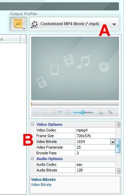

OK, here is what I suggest:
(A) Select:
- "Customized MP4 Movie" from the format list
(B) Select:
- mpeg4 under Video Options
- any of the Frame size options with 720 as the first dimension
- (Optional) 2 for Encode Pass (longer but better quality)
- Video Bitrate at 1024 or lower

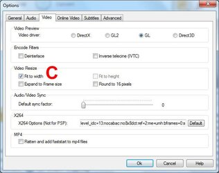

(C) Bring up the Options menu, under the Edit Menu and
- On the Video tab, select "Fit to width" under "Video Resize"
- Make sure "Expand to Frame size" is not selected
Give it a try and report back!

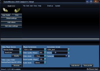

On a suggestion from another thread (on Androidtablets.net) I went and brought DVD Catlyst 4 for $10. It works great. It actually has a setting specifically for the NC! Two step process and you're done.
Cool. Anyone have a few pics of the configurations?
