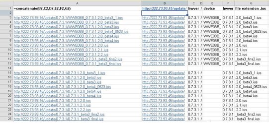

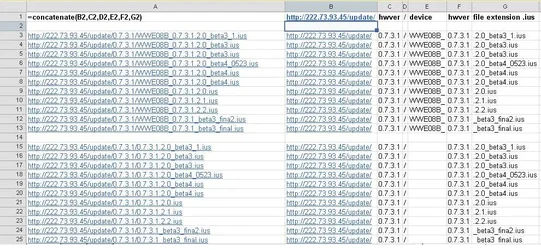

For fun, if you consider this fun, is to try and "discover" the update files. Since it is not possible to browse the update server directories, one way is to try different variations of known update files names and apply them to another hwver.
The links to the update files all follow the same pattern.
"http : //222.73.93.45/update/" + the results from /proc/cmdline where hwver=##.#.#.# + "/" and the file name *.ius.
By concatenating the various parts together using different hwver and update file names, it will produce a link like the EXAMPLE below where the hwver is 0.7.3.1 and using the structure of the file names below in the image.
Code:
[COLOR=#ff0000]NOT A VALID LINK[/COLOR] - [COLOR=#ff0000]This is an Example[/COLOR] - http://222.73.93.45/update/0.7.3.1/WWE08B_0.7.3.1.2.0_beta3_1.ius
[COLOR=#ff0000]Note: This is NOT a valid link, just an Example for illustration purposes only. NO known updates exist for hwver=0.7.3.1[/COLOR].
Using all of the known file names, and in some case a device prefix like "WWE08B_" these were all of the derived possibilities.
Unfortunately none produced any file downloads but as more files are known more attempts can be made to discover newer files.
Wanted: Update file for 8" infoTMIC hwver=0.7.3.1
